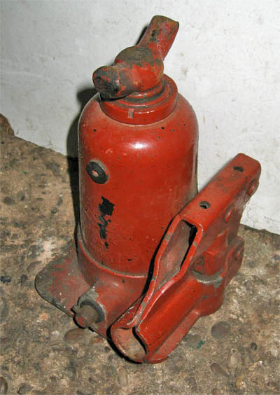

My goto jack is this one. It came out of a "Classic" RangeRover.
I bought one of those 4x4 trolley jacks that go up a long way, but I rarely use it as it is one of those "quick lift" monstrosities that you can't press hard enough to activate the quicklift mechanism when you are close enough to the jack to see where it is going.
