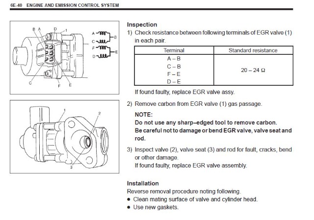

27 Nov 2023 14:19 #252418
by MysterG
Replied by MysterG on topic error 403 EGR
Thanks for that.
After a further hunt round I found a bit in the manual about testing resistance across the 6 pins in the connector.
Whipped mine off again, amazing how much quicker it is the 2nd time!!
On testing 3 pairs show 22ish, but F-E show 8ish.
So replacement valve it is I guess

27 Nov 2023 18:21 #252421
by Scimike
Replied by Scimike on topic error 403 EGR
Good find re info, yes F-E don't look correct, so likely that portion of the coil has failed.
