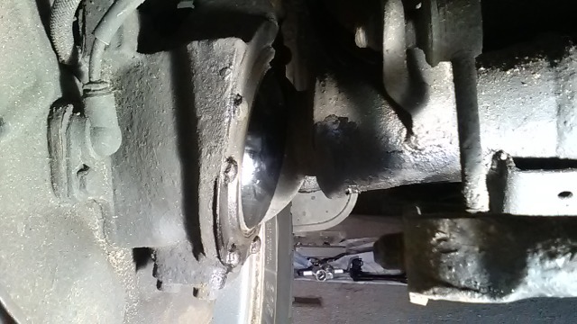

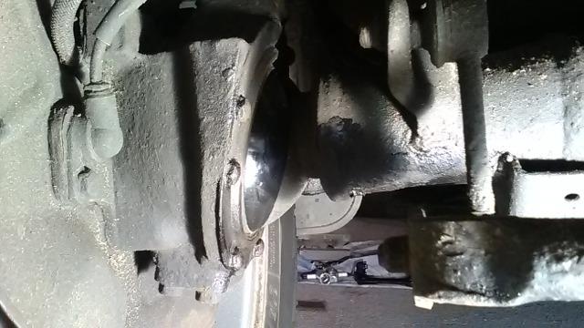

^^^^^^+1 on the POR15 paint if you want to refurbish the surface to give the seal a chance. It's indirectly responsible for the oil leak as this large swivel seal keeps dirt and water out of the kingpin bearings, which when they fail cause the inner axle oil seal to leak.
Picture of refurbished surface with POR15, it's getting on a bit now and done a lot of miles, still good, as are the kingpin bearings.

Leaving them rusty is also fine. I've never touched mine or changed the swivel seal. I've done the driveshaft oil seal and kingpin bearings a couple of times in 100,000 miles of Jimny ownership, its a £30, 45min job.
