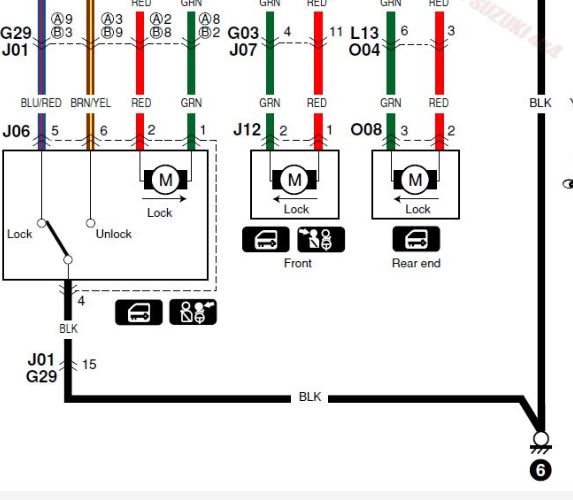

This is the circuit diagram of the central locking

I am not exactly clear on what you are trying to do? Are you trying to replace the Suzuki remote central locking, alarm and immobiliser or just add to it?
If you are trying to replace the Suzuki set up I suggest going to someone who knows how to do it, otherwise you might end up with something not working correctly or something that isn't any more secure than the original system.
