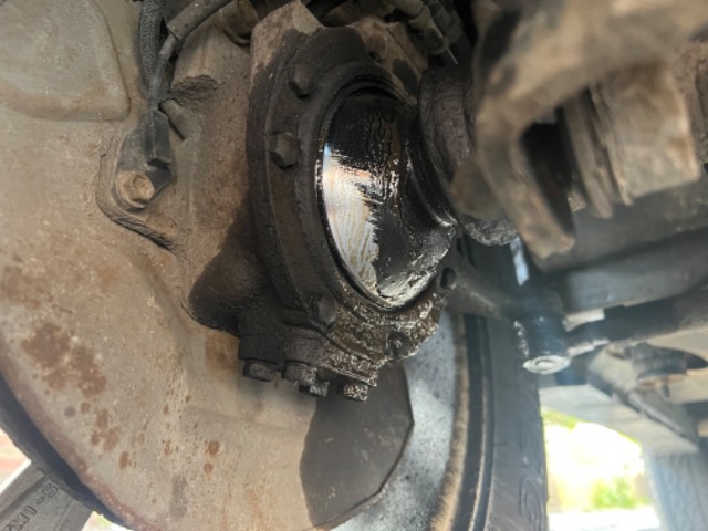

Is my king pin gone?

Replied by DrRobin on topic Is my king pin gone?
Hi,
You will know if the king pin bearings have gone if you get a wobble in the steering wheel at around 50-55mph. It is usually the king pin bearings, not the king pin itself.
If you have got oil on the knuckle that is a sign the drive shaft seal is worn, it wears faster when the king pin bearings fail. It is easy to change once you get the hub off.
Finally the big rubber seal you can see in your photo is really just a dust seal, it just stops dust getting in to the grease round the knuckle.
King pin bearings, the drive shaft oil seal and the knuckle seal are about £50 a side from the BigJimny store, plus whatever your mechanic charges to fit them, which should be about 2 hours labour. It’s a fairly easy job if you can do it yourself.

Hi Robin,
The car has only done 30k and I don’t feel any wobble. So that would point to the seal being gone that you mentioned?

Yes your drive shaft oil seal has failed, hence the oil you can see.
When you change this seal you may as well change the Kingpin bearings, these are normally why the oil seal fails, the play they introduce causes the drive shaft seal to wear. You can sometimes feel the play if you jack the car up and hold the wheel at 12 / 6 o'Clock and push /pull, or steering wobble at 50-55, but not always.
The large outer dirt seal may as well get replaced, as this keeps the dirt out of the kingpin bearing and stops them failing, which keeps the oil seal happy.
£50 for all these parts and max 2 hours to change. Easy DIY job if you feel like a go.
