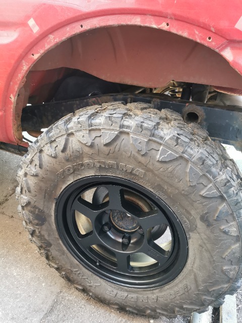

LOL! Fair enough. At the moment I have approx 480mm at the front (centre hub to the arch) and 450mm at the back. If anyone has a stock one (or indeed one with a recent "2" kit) handy, can you let me know what your measurements are please?

Thanks guys - so using Scimike's measurement as a guide I actually have something close to 48mm lift at the front (i.e. near as damn it 2 inches) and more like 31mm at the back, possibly even less given that you tow with yours - so maybe more like 1 inch now.
Anyone else running a +2" that could confirm these measurements please, before I start planning on what to replace?

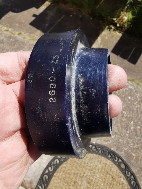

Have you looked to see if person before you fitted spring spacers to get the lift
Look like this on top of coil spring
It's a cheap way of lifting
04 Jun 2023 13:29 #249416
Replied by jackonlyjack on topic Rear suspension bottoming out on rough roads.... where to start?
You could fit a pair of 15mm spring spacers onto rear to level it up for now
Then when you get round to fitting new suspension sell on the 15mm spacers
People buy these to combat the suspension lean
I use one 1" on front driver side.....because i use honda crv rear coils all round
