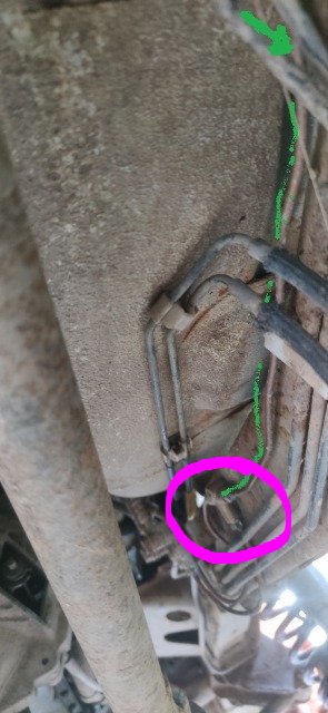

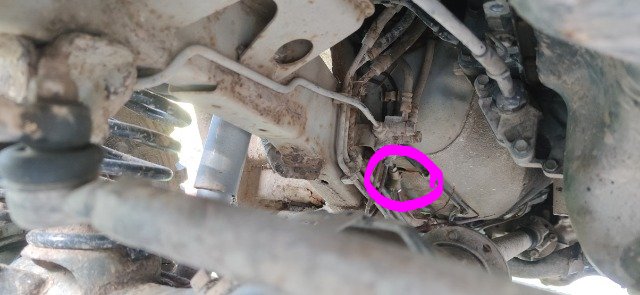

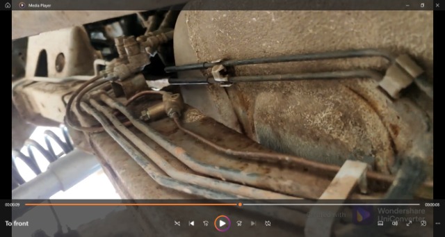

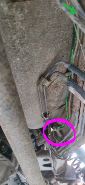

From the Reg, it's a 2002 Jimny Special. Here are some pictures - some have some green lines to indicate the copper brake lines. Does this help?
"As we have no idea what the previous owner did to the braking system...

Where do the pipes on this joiner go?
I can't tell with those small pictures, but it looks to me like one to the rear axle through that valve inside the car, one to the front circuit, and one to the rear circuit, so the 2 circuits are joined.
If you start at the master cylinder.
One pipe goes direct to the NS front wheel (those flexis look a bit short to me, but it might be the photo)
The other two pipes go through flexis to that muddy joiner.
one front outlet goes to the OS front
The other front outlet should go to the load valve above the back axle (that you don''t have)
The single rear outlet goes to the load valve above the back axle.
So two pipes go from that muddy joiner to the rear axle on an unmodified car.

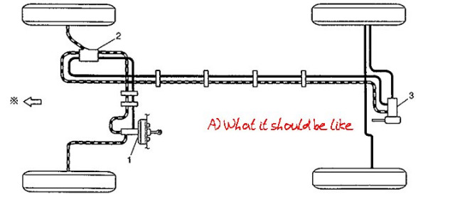

How it should be (non-abs)

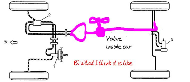

What I think has happened, I am not sure because I can't see clearly, is that someone has joined both outlets for the rear axle together with 2 arms of a T piece, and run the third arm to the back axle through a variable valve inside the car. This is supported by no front brakes or rear brakes when the seal blows.

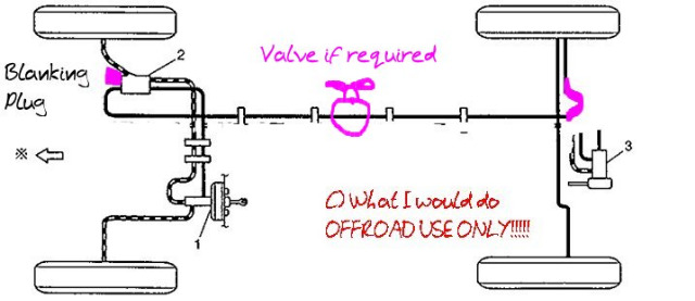

What I would do FOR OFF ROAD USE ONLY is plug the outlet from the front that used to go to the rear so the front brakes are on their own circuit again, and forget the T piece, simply running the pipe to the rear, either direct, and risk rear lock up all the time, or through a new valve. It won't be a disaster if the valve blows now, as the fronts will still work.

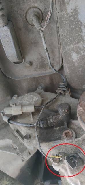

That plug on the transfer box I suspect is the speedometer sensor.
