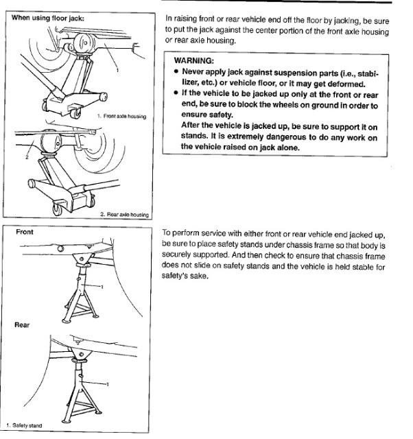

06 Mar 2023 00:52 - 06 Mar 2023 14:23 #247917
by fordem
Slim to non-existent - check your owner's manual it should show you were to place the trolley jack
The diagram above is taken from the FSM for a gen 3 Jimny
Replied by fordem on topic Using a trolley jack
My questions: what are the chances of the diff cracking when doing this and is the use of a trolley jack recommended?
Last edit: 06 Mar 2023 14:23 by fordem. Reason: add source detail
