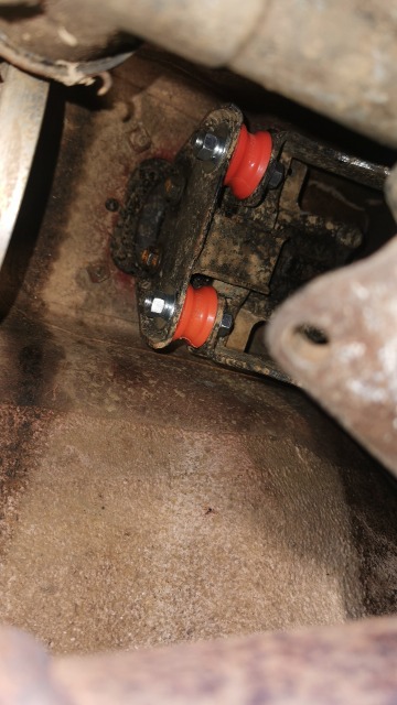

22 Dec 2022 20:17 #246495
Replied by jackonlyjack on topic Gears difficult to engage
Fill the box with redline mt90 oil
also check rear engine mount and the 2 rubber bobbins
i recently replaced mine with austin mini poly exhaust bobbins
Jack
Jack

- JKemo35
28 Jan 2023 12:33 #247226
by JKemo35
Replied by JKemo35 on topic Gears difficult to engage
Where did you get them bobbins? Got a link? Cheers
