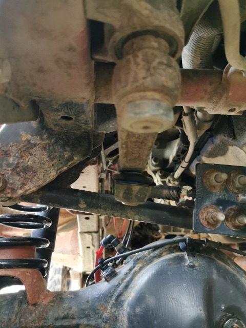

Did you notice the steering wheel was not in same location as before the lift?
Drive it in a straight line, get out and look where the pitman arm is off bottom of steering box
Ideally it should be sat in line with the chassis leg see picture below.
If it's not then you will need to undue both ends of steering drag bar hub and steering box the one in front of axle.
Keeping both front wheels on the ground rotate the drag bar till pitman arm is in location in a straight line with chassis leg.
However this will probably not fix your airbag light situation
