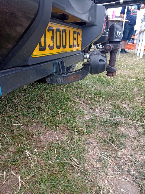

Replied by Lambert on topic Which Tow Bar

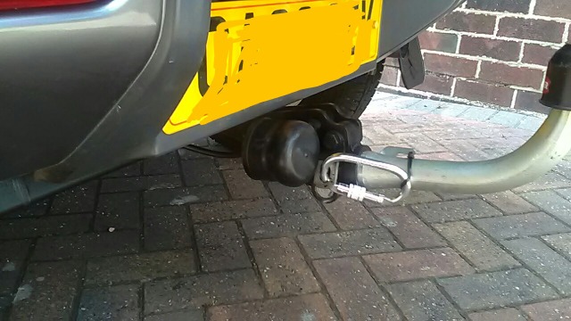

by Scimike
Replied by Scimike on topic Which Tow Bar
And just to complete the line up:
Here is the Witter.
The main horizontal mounting bar is tucked higher than most, and the swan neck clears the spare as per the OEM Suzuki. The mount hangs lower from the horizontal mounting bar than most due to the release system. So I suspect this makes it the lowest, but I do like the fact that I don't bang my legs on the hitch when it's removed, which is a two second job.
However, to give all this a meaningful dimension the distance from the bottom of the rear bumper plastic to the lowest part of the swan neck mount is just about 5 inches.No point measuring distance to floor as this will change with tyres and suspension changes / wear.
Hope this helps you decide.
Have fun.
Here is the Witter.
Have fun.
