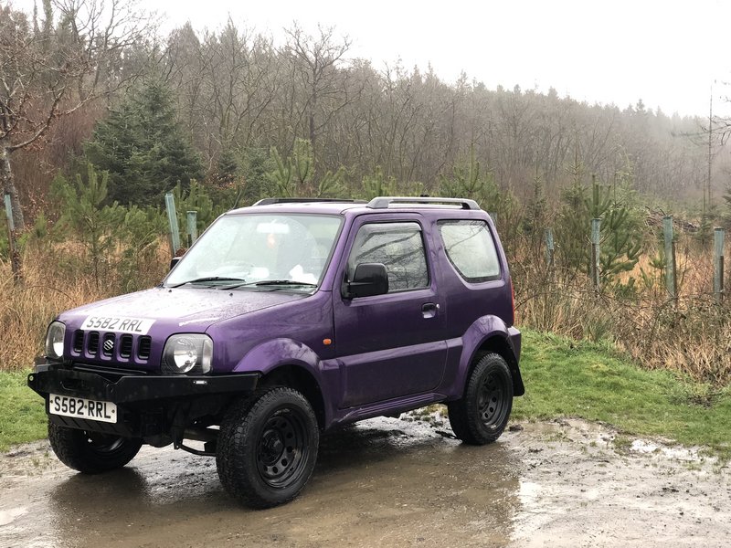

At the start of February I suffered major brain damage, sold my very reliable and comfortable Mercedes C-Class and picked up this lovely little 1999 Jimny with 109k on the clock for far too much money:
Since then it has been non-stop ingesting the contents of my wallet, including but not limited to, NSF wheel bearing, thermostat, head gasket and a skim, a new head unit and speakers all around, a winch, manual AVM locking hubs and a NSF wheel bearing, again.

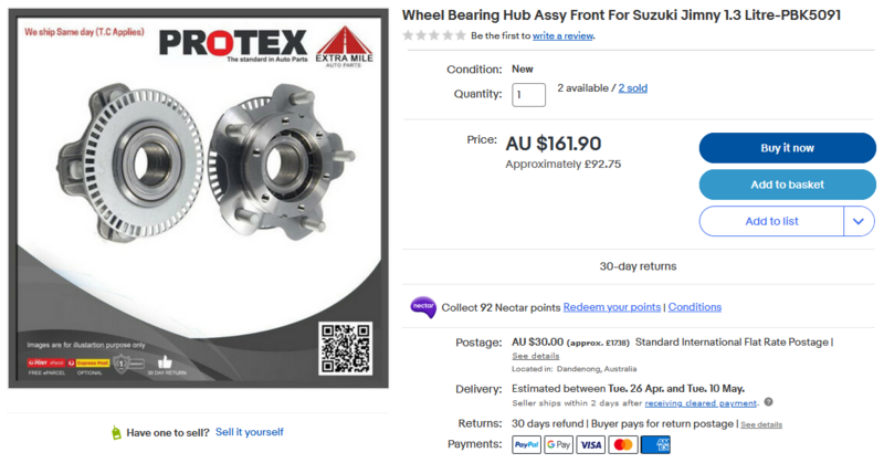

For a car that was made basically unchanged for 20 years up to 2018, the front hubs seem to be made of unobtanium in the UK. None of the parts places near me can get them, there's no used ones on ebay that don't look like they've spent 15 years in the sea, and new ones are eye wateringly expensive, shipped from the other side of the world.

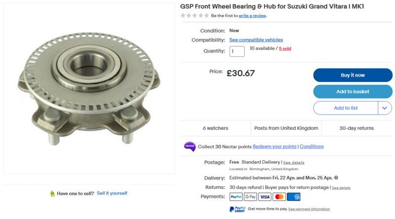

What are the odds that a Mk1 98-05 Grand Vitara hub fits the Jimny? From what I can gather the bearings are the same type and dimensions. I don't need the seal at the back for the vacuum hubs because mine are manual. (or the ABS ring for that matter)
Wheel-Size.com tells me that the centre bore, PCD and thread sizes are the same. For £30 i reckon it's worth a punt even if the bearing is cheap rubbish as I now have several nice KOYOs waiting for homes.
Before I pull the trigger on that, does anyone have any experience/alternatives?

Oh and from memory there are 2 sizes of center bore early ones being 107mm and later being 108 , think it changes around 2005 I think.

The last time I purchased the hubs for someone was last year when they were £126 each. I would have to quote again but they would be slightly higher now
And that £30 one for the Vitara sounds like it is made of Chinesium for that price

Chinesium (too funny)
