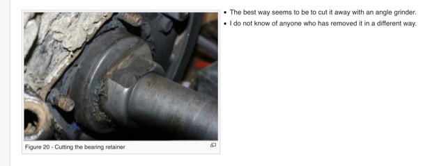

Good morningI have a jimny and need to change the back wheel bearing which is with abs which I do not use so I do not have the abs ring on the collar is it possible to use a standard collar instead of the long one pls

taught so tks and if i remove the ring collar would it be safe to refit the same collar ?

I very much doubt you’ll be able to “remove” it?!
Theyre generally cut off…
Here’s a link to the BigJimny WiKi -
www.bigjimny.com/mediawiki/index.php/Rea..._bearing_replacement
step 20…
Dave
step 20…
Dave

You can remove it by using a suitable puller but it is not recommended that you reuse it. The ring collar is what keeps the bearing in place so it's critical.

a friend of mine told me he removed it with heat and refitted it with heat again next week i am going to his shop and see how it is done and if it is safe to refit
