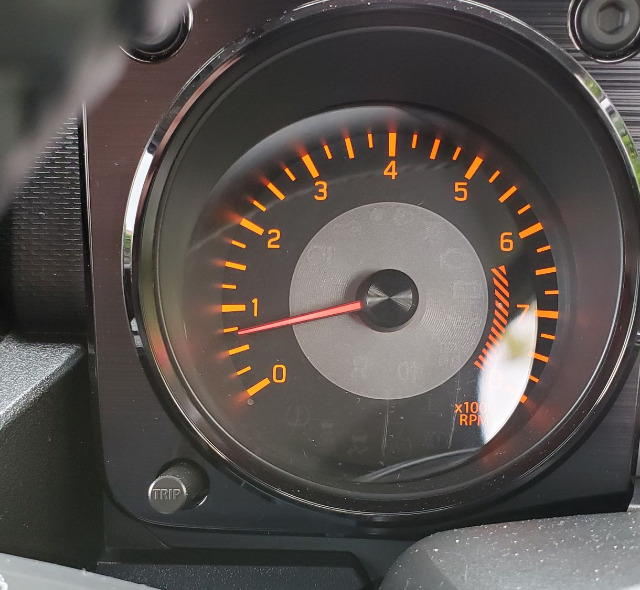

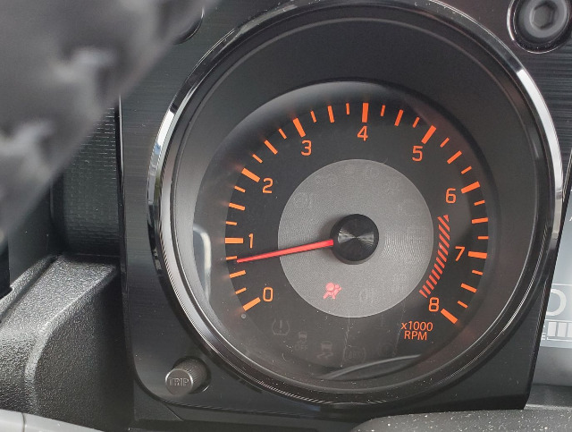

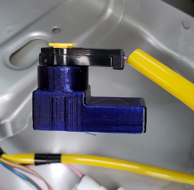

28 Nov 2021 06:41 - 28 Nov 2021 06:43 #240360
by Kiwi38
Replied by Kiwi38 on topic Gen 4 Rear Seat Belt removal
Last edit: 28 Nov 2021 06:43 by Kiwi38. Reason: Too many pics

Well done Kiwi38. Just two questions, did you use the resistance in Martins list and did you need to do both sides/
Cheers
Roger
Cheers
Roger
28 Nov 2021 18:03 #240370
by Kiwi38
Yes, 2.2 ohm resistor and both sides.
Cheers, Bill
