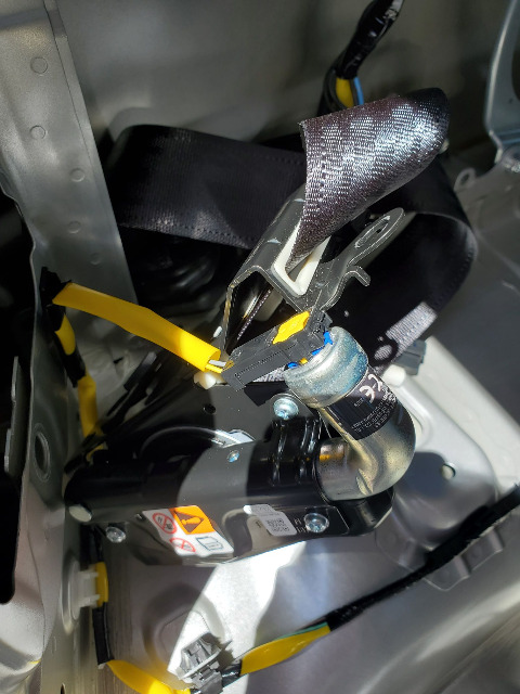

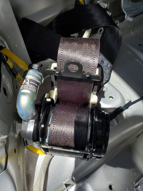

I've removed the rear seats from my new 2021 Jimny and plan to put in a flat floor.
I've a question for anyone who might have already removed the rear belts.
There's a plug fitted that's not immediately obvious how to remove it, or indeed, if it's removable. See attached pics for the offending item.
It looks a little nanny state and I wonder if there are unforeseen consequences to its removal? I could bundle the belt section up in a cloth and stow it inside the shell but it would be tidier to take out the whole unit. Thanks in advance for your help.
Cheers, Bill
Cheers, Bill

Good morning Bill and welcome to the forum.
Your thoughts and my thoughts jelled on this subject. I have removed the seats, so lets remove the belts.
Except it is not that simple!
I found the connection to the electronics and removed the little clip. So far so good. With the belts removed I switched on the ignition and the little light on the dash came on. Put seat belts on. I tried bypassing the connection. No joy. I thought about this and I thought about that but electronics are not my forte so in the end I re-connected the belts and stuffed/taped them inside the bodywork. At least they are out of sight.
Roger
Roger

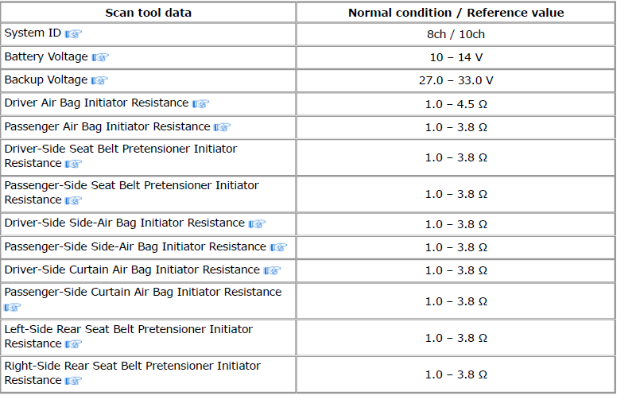

19 Nov 2021 20:08 - 19 Nov 2021 20:23 #240221
Replied by mlines on topic Gen 4 Rear Seat Belt removal
If its the circuit (little plug) that goes onto the rear seat belt mechanism at the bottom of the rear pillar then it is the seat belt pre-tensioner circuit
Obviously you have to be careful with any part of the active restraint system. The recommended way to work is with the battery negative disconnected and the "A/B" fuse removed, waiting at least 90 seconds for the system to discharge any residual electricity.
The pre-tensioner circuit is continually tested by the Airbag system and will put up error messages if it is disconnected. I believe it is not a sophisticated test, it simply looks for a resistance in the circuit as per the table below
I believe you could put a simple resistor across the connections to make it think the pre-tensioner is still there
I AM NOT AN EXPERT ON THIS. YOU PLAY WITH THE SAFETY SYSTEM AT YOUR OWN PERIL.
