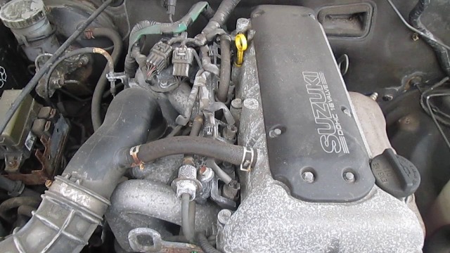

Also just popped put and checked for engine number/type. No sticker in either door shut (other than tyre pressures at drivers side) but metal plaque in engine bay has the engine code as MRK5CCD02. Any ideas?
- Podge
11 Nov 2021 13:38 - 11 Nov 2021 13:39 #240030
by Podge
Replied by Podge on topic Spark plug choices?!
Show us a photo of the engine and we'll tell you. If it's a hard top it's more than likely a M13 engine looking like this.
I've been using NGK BKR6E-11 in my Jimny. They're bog standard plugs, just need changing more often than iridium ones (10-15k interval or so). Bonus is that usually you can get all four for under a tenner on eBay/GSF/ECP etc. Previously had Bosch plugs and didn't notice a lick of difference. Jimny has 86hp or so. It's not a high performance motor and I don't think Iridium plugs are going to make a noticeable difference other than to your pocket. But that's just me.
