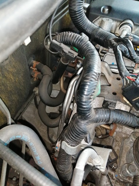

Replied by fordem on topic M13A Missing Cam Sensor & Melted Connector
The yellow circled connector appears to be on the power steering pump - if that's correct it's the power steering pressure switch - when the steering is turned the oil pressure in the power steering system increases and so does the load presented to the engine, the increased pressure closes the switch, which the ECU senses and increases the engine idle speed to compensate for the increased load.
If the switch is disconnected it will not prevent the engine from running, what you may notice is the engine idle speed drop if the steering is turned with the engine idling.

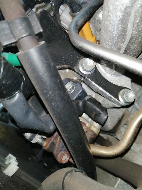

11 Oct 2021 17:25 #239321
by Scimike
Replied by Scimike on topic M13A Missing Cam Sensor & Melted Connector
So is this the cam sensor on a 2009 M13 engine?
if so this is rear left looking from the battery side.
something sensor like is lurking at the back of the M13, best photo I can take.
This is a totally unmodified 2009 hard top, so it's as it left the factory.
Tip cold water over it next time your vehicle won't start, if it then works that's your problem.

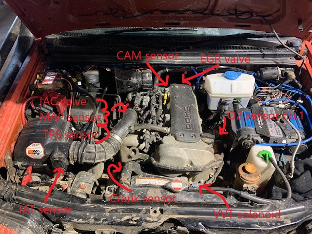

12 Oct 2021 17:06 #239344
Replied by Riccy on topic M13A Missing Cam Sensor & Melted Connector
Correct Mike.
Heres a pic I have scrwaled on to show where the various things are:
So starting with the CAM sensor at the top of the pic and working clockwise:
CAM sensor - senses the position of the cam and the engine wont run with it disconnected or failed. ECU should log and put on EML (engine dash light). Failing sensors can be cooled to temporarily improve performance.
EGR valve - lets a bit of exhaust gases back into the inlet manifold. can stick open and cause poor fuel consumption and/or increased build up of sludge in the inlet manifold. Removal will put on EML, faulty not neccesarily.
O2 sensor no.1 - exhaust gas sensor and ecu uses to adjust the fuelling. Will put on EML if removed or faulty. There is another in the cat on the exhaust further down too.
VVT solenoid - adjusts the cam position at higher rpm. Effectively switching from an economy setting to more of a performance cam angle.
Crank sensor - similar to CAM sensor and located hidden behind the alternator and hard to access.
IAT sensor - senses the temperature of inlet air (may also have a flow meter in it). ECU adjust fuelling to suit cold start or running.
TPS sensor - tells the ecu the position of the throttle and it adjusts fuelling to suit.
MAP sensor - Manifold air pressure sensor (barometric sensor). again used to adjust fuelling by the ecu.
IAC valve - Lets a varying amount of air past the throttle butterfly when in the closed position. ECU uses it for cold starts or the idle up function (e.g. idle up for power steering or aircon). Can get gunged up and stick open causing a high idle speed when warm or problems with cold starting.
There is also a coolant temp sensor and a oil pressure sensor. possibly a knock sensor too which are all not visible in the pic.
Feel free to enlarge on this anyone if you have more info or I am wrong about something.
The OP's problem could be vac related or from the above stuff it maybe IAC valve or one of the other inlet sensors. Defo not the cam or crank or it wouldnt run at all. It does sound like the ecu is shutting it down. A code reader would help a lot with diagnosing the problem. A compression test isnt a bad idea given the history, but its running for a short period, so unlikely.
Try starting it and keeping it at about 3000 rpm with the throttle pedal. If that works and it keeps running hold it there for about a minuite to get a bit of heat in it, then see if it idles. If it idles ok or high then its the IAC valve, if it idles rough or not at all then maybe TPS sensor or a vac leak. IAC valve can be cleaned out easily enough if gunked up, then have a look at the EGR valve too as thats where the gunk will have come from no doubt.
Hope that helps
