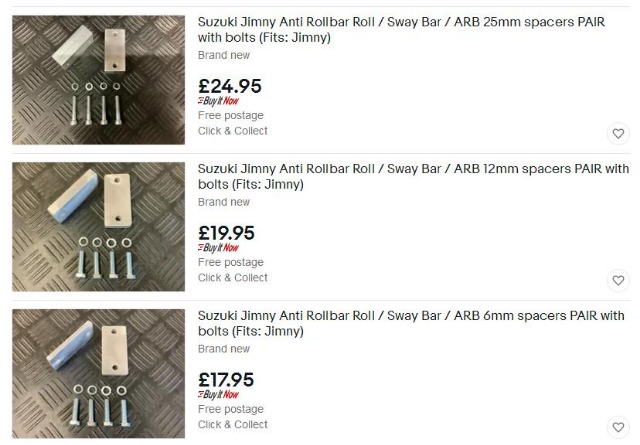

I've just launched a range of these -
There's 6mm, 12mm, 25mm available now, and 38mm going into production as soon as the bar stock arrives...
Link to eBay
Dave

Thanks zook. Do these also fit the gen4.

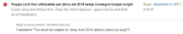

No, they're apparently different spacing between the bolt holes...
Hence my one single negative feedback
(The delivery time comment was unfair as they were shipped via eBay's Global Shipping Program!!!)
I'll have to order a bush metal loop strap (from Martin) to research and produce them for the Gen4...
Cheers,
Dave
