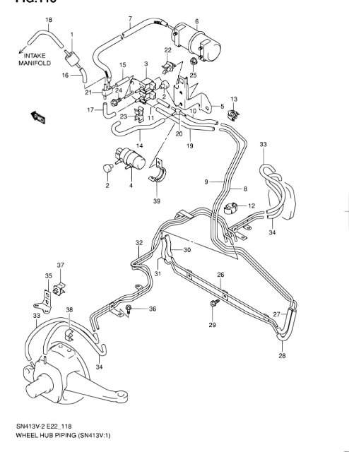

Hi.
I read in the "Jimny wiki" its possible to drive in 2WD-Low in a Jimny ho has a button operated transmission system if you modify the white cables to the solenoid for the front vacuum hub heads.
My English i bad and i dont understand if i should short circuit the white cabels to the cars ground, or just cut the white cables and put a switch on if i will have 2WD-Low ability ?

As I understand it, put a switch between the two wires, no cutting. The switch will connect the wires. Someone Please correct me if I am wrong.
På svorsk: ansluta och koppla en brytare mellan dom två vita ledningarna så att den kortslutar för at legga ut naven i framaxeln.

I cannot comment on solenoids and switches but there is a much more simple solution to achieve the desired 2WD-L mode:
Discard the vacuum hubs and install manual locking hubs instead.

Short circuit sound like a bad idea. I'm interested mod my car, but don't want to kill 4wd controller.

Manual locking hubs vill work, but is not optimal on a every day car.
A switch is a easy fix whit few disadvantage if it works.
