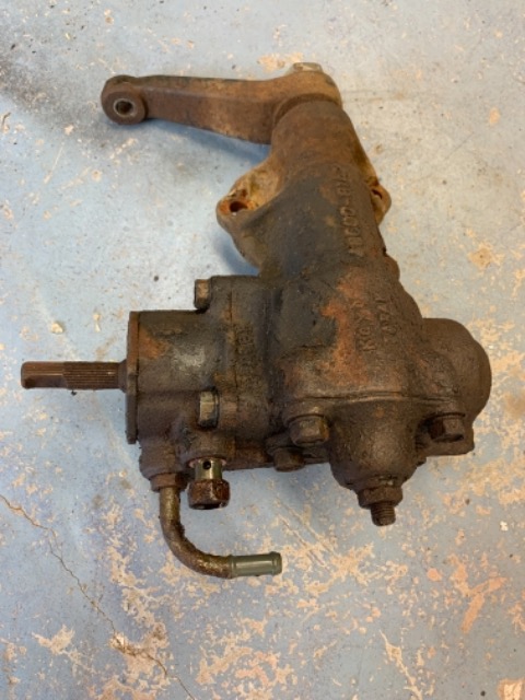

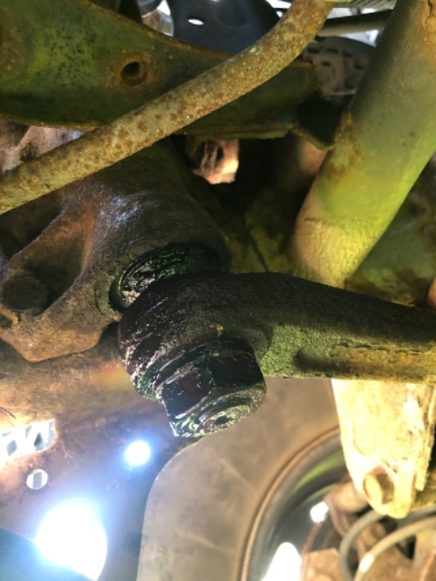

Looks like mine is leaking from the bottom as it’s dry everywhere else. I assume it’s just the 3 bolts to remove it.
Anyone doing a rebuild kit or exchange service of these ?

I haven't found any such service. Or a video or how-to service the box other than for other makes or more general. Seems that it is not possible or profitable.
Please correct me if I am wrong!
