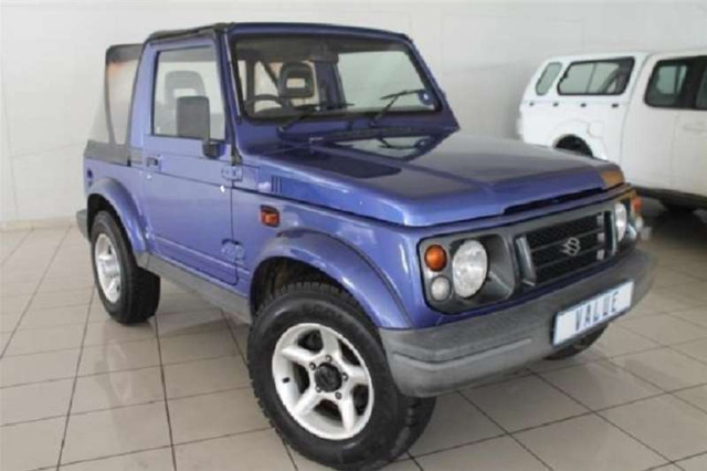

If yours is tagged a Jimny, I assume it is a JDM model. If your "Jimny" looks like this (similar to a JA11) it is a late model SJ413:
The Samurai stopped being sold in the U.S. in 1995. Rather than getting parts there, You may want to check the Australian market for spares as they continued receiving the later model (96-98). They did come into Europe as well but I think the quantity was limited. From my understanding it is known as a SJ80 (even though it is a 1.3 litre) with an internal code of JB32. In Australia they normally just refer to them as coilies.
