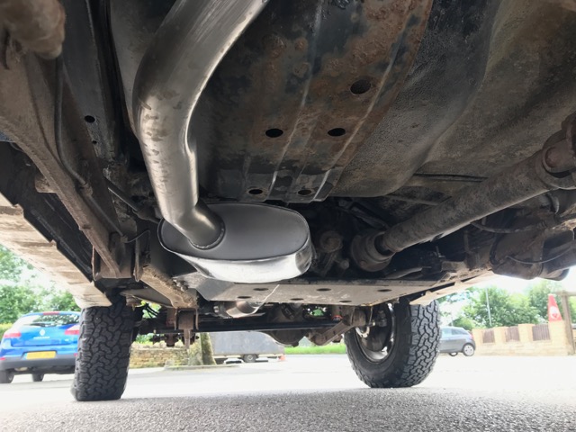

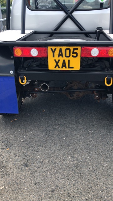

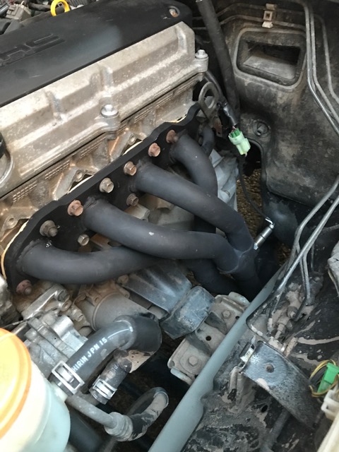

The standard Jimny exhaust is very restrictive..... When my car was converted, initially it just had the back box removed and the pipe cut just above the axle. Whilst being noisey, I could notice a little more torque and a bit less movement up and down the box when driving.
I went to Tony Banks (Longlife) Exhausts in Leeds, he fitted a Redback Headers 4-2-1 manifold that I got from Ausralia and he built a full stainless 2" single box system with a 200cpa sports cat. The manifold was £230 and the system £600, madly expensive for a small improvement but something I do on any car that I keep for a while.
On the 1300VVT the results were good, much more drivable, more torque, fewer gear changes....... Probably a bit too raspy for a mature driver but you can go back to Tony Banks and he will alter the sound FOC if you are unhappy, I didn't.
On the 1600VVT the sound has deepend a little and drivability is great. Pulls cleanly from 1500rpm/25mph in 5th if you are gentle, is happy to roll along at 20mph in 4th and picks up fine. Hills have very little impact..... Still a bit too noisey for a mature driver but at 54 I'm unlikely to mature soon..... I drive gently around town to avoid too many stares.... but if I pass you on a full chat 3rd gear overtake on a B road, you'll look.....
The emissions tests were fine at MOT, I told the tester to get it hot as I was instucted to, when asked, he forgot and just tested it and it passed...
A worthy modification in my book but others will look and think it's crazy at those prices....
