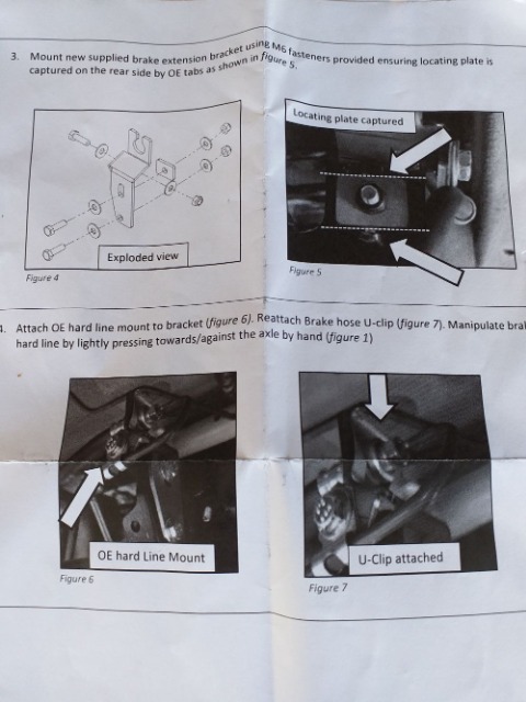

2 Re the brake hose extension some seem to use this, some dont, OME use a brake extension bracket to get over this problem not a brake hose extension.
