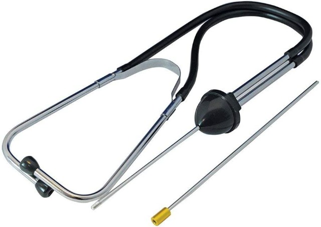

If the wheel bearings are not showing any signs of problems, eg movement or rough feeling when rotated then the only option is to go old school.
You need one of these and have a listen to each side as you turn the wheels.
Mechanics stethoscope.
Very effective at locating the source of those strange noises. If your bearings are ok I would expect both sides to sound much the same, one side louder than the other it's likely the loud one is on the way out. If you hear a rumble on both sides have a listen to the diff area to see if it's the source. Not much money, about £6.50 on Amazon, a worthy item in the tool box even if it's no help this time.
