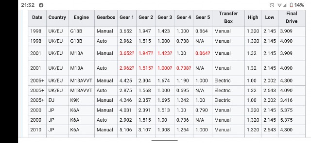

You really suggest tcase cooling, not auto gearbox cooling?
Btw, would there be an issue with the reduced gearing eg no more top speed or smth?

Transmission cooler not transfer box. You will potentially experience lower top road speed but that would depend on which gear set you went for. The standard ratios for the boxes are in the Jimny information section on the top banner, and a site called grimmjeeper has a calculator to allow you to adjust for different tyre size.

Fit VVT 4.3 diffs and you would have the same drivetrain as me bar VVT.
1600VVT + R7ME gearbox + Manual (stick) transfer box + 4.3 diffs + 30" tyres...... My shafts are standard.
It goes well for a Jimny, powerband and road speed are well matched and eager in all gears... 70mph @ 4000rpm, could probably handle 31" comfortably......
Start going above 30" tyres and most I know who use them to lane, have needed Longfield shafts and CV's following failures of standard kit. On a road car it might not be such an issue.... but it's why I'm staying at 30" for now. If i go bigger than 30" I will fit H/D shafts and CV's, so £800 before you look at tyres..... Might be on 30" for a while yet lol....

I got the trailmaster gear set. 1,6 VVT and 235 75 15.
Work well, but there is room for 30" I guess. Without them the car was more or less useless offroad but ok on the highway. A bit high rev now on the highway but ok if I had 1,3.

Don't forget this refers to an automatic main box which has different ratios.

There may be some benefit from changing to a manual electronic transfer box but I'm too thick to do the math.....

I had missed that Lambert, thank you..... VVT diffs would still be of benefit but you would be looking more to 30" tyres....Lambert wrote: Don't forget this refers to an automatic main box which has different ratios.
