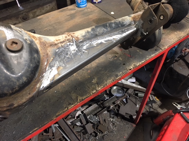

I use the weld on braces or gussets that go either side of the diff pumpkin to brace over the welds from diff to axle tube and they make it pretty sturdy. I would doubt theres much chance of smashing the diff itself unless you are thinking of doing jumps with it or entering King of hammers type events.
