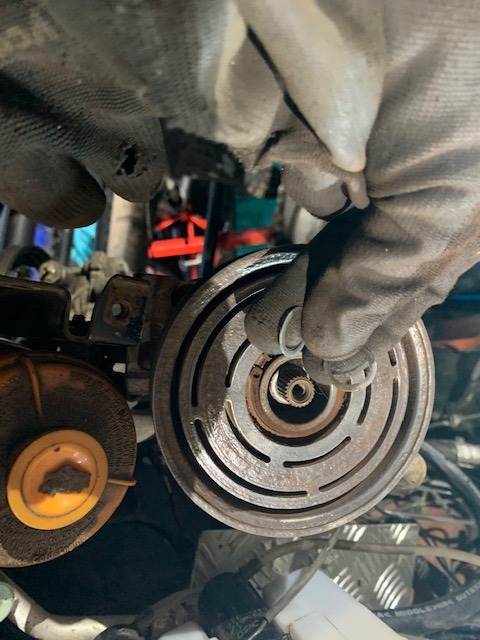

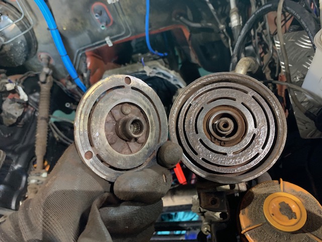

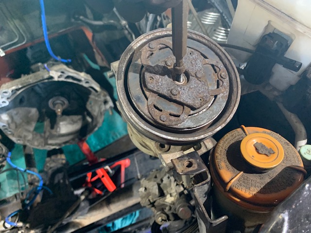

Always getting cold air is a symptom of the compressor clutch being stuck on. The pipes from it will ice up under the bonnet and maybe even the heater matrix inside, which then defrosts and rots the footwells (or at least thats what mine did)
The compressor clutch plate is held on by the allen key in the middle, but probably the clutch plate is rusted 'on' now. If you can get it off and clean up and re-shim it'll work again. Or can just fit a shorter belt to bypass it altogether instead (4pk850 i think). Note its easiest to unbolt the compressor from the engine and lift it up to work on.
shims (washers basically):
You can bench test the clutch by applying 12v+ to the only wiring connection on the compressor (body to negative). This will make the clutch pull in/out as voltage is applied/removed.
There are 2 relays in mine for AC, both located in a separate box of their own on the side of the battery fuse box, is that where yours are? One is fan and the other is compressor.
