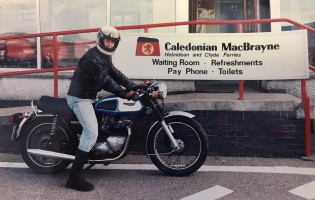

A bit off topic, but a neighbour round the corner has a Commando, probably the same year as yours, very nice.
I have a 1977 Bonneville, I have had it since 1985 and completed a couple of rebuilds. It is off the road at the moment waiting it's third rebuild, I am saving it for a retirement project now.
You might recognise the Norton pea shooters.
Taken in about 1993 at Oban on my Western Isles tour.
