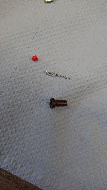

Sadly jimny-less but still got the bug!
Replied by theoldseacaptain on topic 4wd low and high panel bulbs
I changed one on mine - trying to find the receipt! Got the bulb online and think it was a German website.

Thanks Cap'n
It looks almost like an LED. How did you remove it Dan - does it simply unscrew off the board?
EDIT:
OK I found this VIDEO LINK
From that, I fathomed these are probably T1 12v 60ma Wire Ended micro bulbs
They're available HERE or probably from the usual suspects such as eBay
EDIT:

Replied by Daniel30 on topic 4wd low and high panel bulbs
That looks like the ticket thank you very much
When I get the bulbs and fit them if everything works ill send you some
if that's all you need, I have got a few variations coming now so I will see which one is the best, I have sourced aone with a holder attached but will have to see if they fit in and lock in the panel
