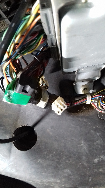

10 Dec 2019 08:16 - 10 Dec 2019 08:19 #216348
Replied by mlines on topic Re:1998 Jimny high idle
It's just under the dashboard, on the UK model just up by the drivers knee. On the LHD version it's the mirror image.
But you have the G13 version which is not readable by commercial readers.
Instead you need to link the connector behind the glovebox and read the dash lights. Therefore you can't read continuous readings

10 Dec 2019 10:07 #216353
by giacomom
Replied by giacomom on topic Re:1998 Jimny high idle
Thank you mlines
in fact, that's exactly what I was asking for
Is the pic of white connector the one I need to use for the diagnosis ?
Giacomo
Giacomo
10 Dec 2019 11:18 - 10 Dec 2019 11:19 #216355
It looks like it to me
It should have 3 wires going to it
Red with green strip
Pink
White with blue strip
Pink

10 Dec 2019 12:00 #216356
by giacomom
Thank you
starting from above :white/blue strip
black - pink- red/green strip
but the strange thing is that at the bottom right of the steering wheel there is also the classic diagnostic socket OBD2......
Giacomo
