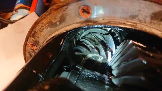

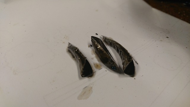

Knocking noise from the rear occurred so went home and took the diff out. Pinion had lost three theeth. Broke them clean off. Mine is a 05 so I will need a new 4.3 diff. Got 235's so I need the reduction. I have many samurai diffs but they are 3.9 and even though I have 17% reduction in the transfer case it wouldn't be a good option..
Is this common?

That's impressive. Diffs are usually quite reliable even with quite big tyres. Was there any evidence of prior wear in the pinion bearings or were you working it quite hard when it failed?

Both gear backlash and bearing clearances seem just fine from what I can see and feel. Way better than most Samurai or SJ diffs i have set up by just throwing them together more or less. and i had lockers and 31" inch tires in those, and they are just the same except for the ratio. Those were old ones from 1985 to 1988 though. nothing is like it used to be when it comes to cost and quality.
If I had a gear wheel breaking like this at work I would say there could have been something wrong with the material..
At the time I had my Suzuki trailer with approx 3-400kg total weight and took off from home in first gear.. Wet partly icy paved road.
I am very pleased with the power in it now and I must say I do like to floor it as well.. So it has probably been strained a bit.
And I did break my gearbox too last year.
