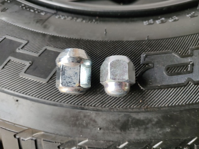

I've just bought a full set of secondhand SZ4 steel wheels so that I can have a play with base-spec looks and do some fuel consumption comparisons between stock tyres and my 215s.
I was expecting the nuts to differ between my SZ5 alloys and these wheels, but they appear to be identical. Can anyone with a SZ4 confirm that the nuts on the left in the picture are the same as those used on the roadwheel (rather than spare) on their car?
Picture shows nuts used on my SZ5 (and supplied with the steels) on the left and the nuts used to hold the spare in place on the right.
7 years 2 weeks ago #215359
Replied by mlines on topic Gen4 wheel nuts
The parts catalogue shows the wheel nuts to be the same on the steel (SZ4) and alloy (SZ5) models.
