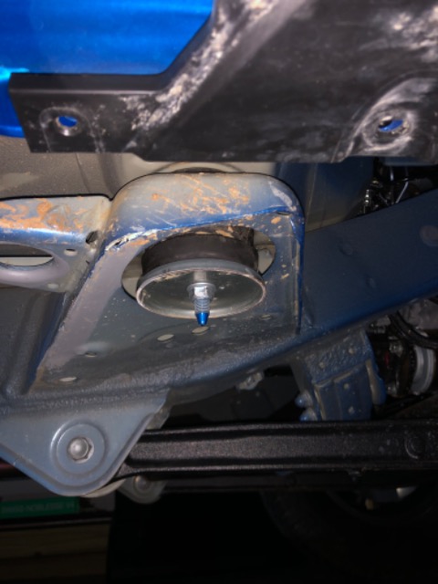

6 years 4 months ago - 6 years 4 months ago #225274 by Willie
Replied by Willie on topic Body Mount Nuts, Torque?
I had a question as I'm a complete novice, machanically, can you just remove the cab mounting bolt without bracing anything. I'm to scared to undo the nut because I don't know what will happen. I need to remove them to fit rock sliders and didn't realise you had to undo those bolts
