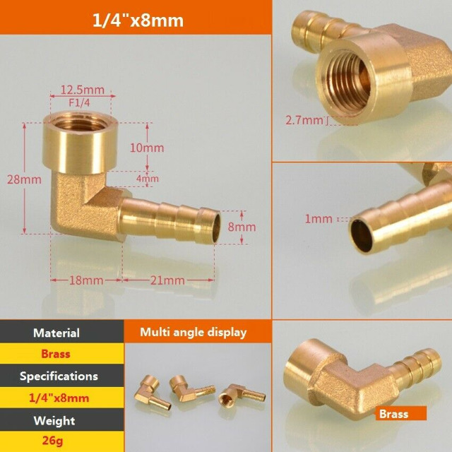

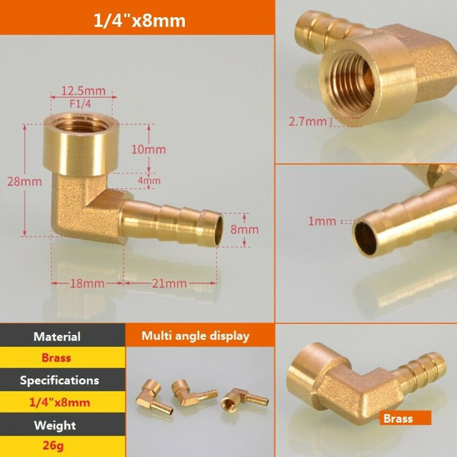

13 Jul 2020 19:00 - 13 Jul 2020 19:01 #225013
by Grim Reaper
Replied by Grim Reaper on topic Jimny Gen 4 Diff Breathers?
Last edit: 13 Jul 2020 19:01 by Grim Reaper.

13 Jul 2020 19:56 #225021
by DAGZOOK
Replied by DAGZOOK on topic Jimny Gen 4 Diff Breathers?
Possibly, the general consensus seem to recommend running a 1/8 bsp male tap internally down the axle housing breather spigot. But I gather that tends to be a job when the axle has been removed or the vehicle is heavily lifted.. much prettier end result. Bit daft that Suzuki made the breather spigots so big in the first place!
