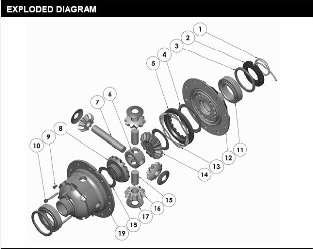

You have a piece in this picture that is very clearly damaged. In the lower middle of the picture is the cup portion of the carrier bearing. Directly above that is the damaged piece that I am referring to. Is that the air seal housing that the air line connects to? I'm referring to item 2 on this diagram.
I'm not really sure how that would be damaged if the internals of the locker itself failed. Did the carrier bearing on that side fail? Perhaps someone with more experience with air lockers can provide some insight.
It's never bad to have spares available but you may want to save money and confirm what the failure was before buying a complete front axle.

I don't really have much knowledge of the diff mechanics and parts, and my mechanic never seen an air locker so he is not sure what actually broke first. But there was a lot of damage, since he called me as soon as he opened the housing to show me that there were parts lying in it. I remember the brass airline was stretched and looked like it snapped off, as its end was deformed. So the part you refer to is likely the air seal housing.
Still, I can't be sure what the mechanic himself damaged while dismantling the unit. In any case, there are still some noises and even vibrations somehow caused by the front axle, even though the shafts should be disconnected. I think it may even be some damage somewhere in the axle or more likely the shafts moving side ways and engaging with the front wheel couplings.
