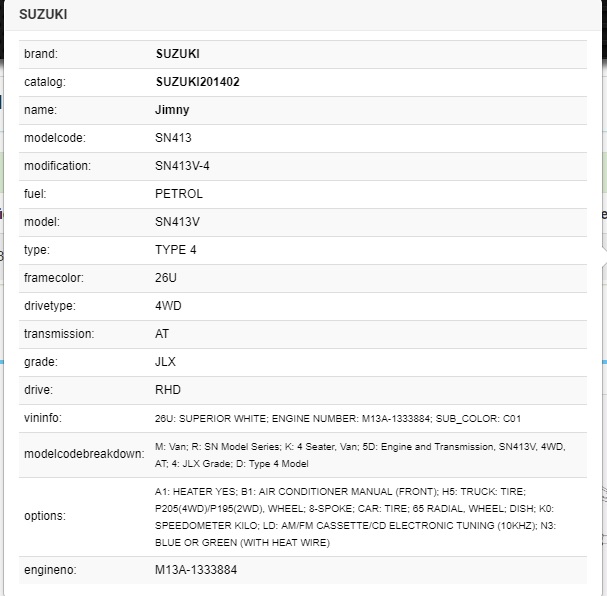

So for some reason my VIN is not found on that website. Any one know how to tell what jimny i have otherwise? all i know is the seatbelt tag says 2003, its an M13 engine with steel wheels not alloys.
VIN tag says JSAFJB43V00185164

thanks for this, however i notice it doesn't tell me the transmission code. how can i find that out?

yea i came to the conclusion i am gonna rebuild it, change clutch bands, seals etc. so now i am trying to figure out the transmission code so i can order the right rebuild kit from cobra transmissions.

If you are under the transmission facing the front of the car the id number is on the left hand side of the transmission towards the rear of the housing.
Its hard to say what the code you need would be, most of the manuals you can access in the UK are for UK or European models where autos arent as popular.
Japanese and US markets prefer autos so there are more likely to be different models of transmission.
