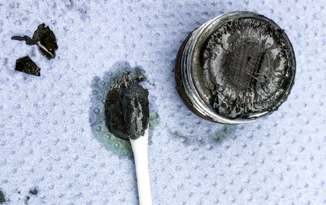

Hey up.
2013 model.
Just dropped the front diff oil. Last done 2yrs ago.
See on pics a little sludge on plug and a few what look like metallic shavings. Only thin but like paint flakes.
The sludge/debris not as black as in the pics, more silver/greyish. The oil itself looked nice and clean and brownish.
Any hows, does all look ok or is there anything I should be concerned about ?
TIA

Replied by Riccy on topic Front Diff Oil debris
Nah, thats pretty standard.
The last oil change would have flushed remaining debris from the axle casing, this is what you are seeing
