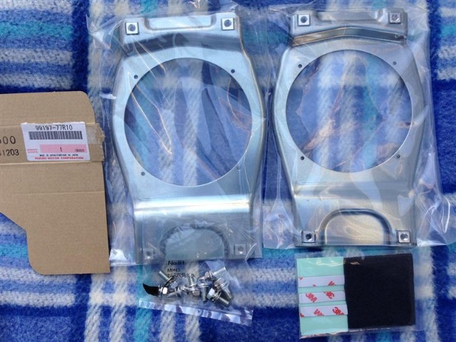

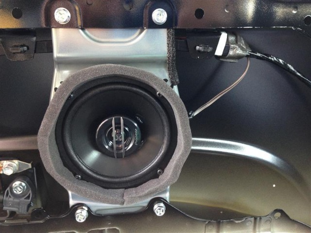

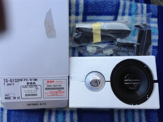

Pulled the trim off earlier (well, at least the top of it, to have a look behind). Nowhere to mount speakers as standard, doh!
Japanese accessory catalogue lists brackets for rear speaker install (99197-77R10) and 13cm Pioneer Speakers to fit with correct wiring harness (99000-79BJ0-R00).
Found these pics online:
