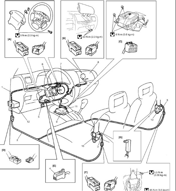

Replied by mlines on topic Switching off passenger airbag?
A couple of quick and dirty ways of doing it, both of which will result in an Airbag warning light coming on all the time on the dashboard.
1. Pull "AIRBAG" fuse from the fuse panel under the dashboard. BOTH airbags and seat belt tensioners will no longer function. (number 12 in picture)
2. Disconnect passenger airbag connector behind glove box. Passenger airbag will no longer function but driver and seat belt pretensioners will work ok.(Plug B in picture)
