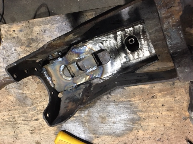

You need to cut the R72 bracket and weld onto the existing R7me bracket. On the R72 this bracket just serves as a rear support bracket for the engine & gearbox as a whole. On the R7me it also does service as part of the gearstick linkage mounting.
This means you need to keep the R7me bracket as it is and weld parts cut from the R72 bracket onto it. Having done this job once already, I would say that the pictures say most of what's needed. The thing I have done differently this time is to weld some 10mm steel spacers to the bracket before the bits from the R72 in the hope of getting better prop alignments.
The two brackets back to back:

The R72 bracket cut:
10mm plate spacers welded onto R7me bracket:
Brackets welded together:
Another view with the new bushes in as well:
These new bushes are to hold the gearstick mount in place. They replace the square ones well and are much cheaper than the Suzuki parts. These come from Halfords and are intended for a exhaust on a classic mini. Come in at less than £2 each.
Bracket back on the box and painted up quickly. Needs to come back off to get the box into the car so this is just to show how it looks:
