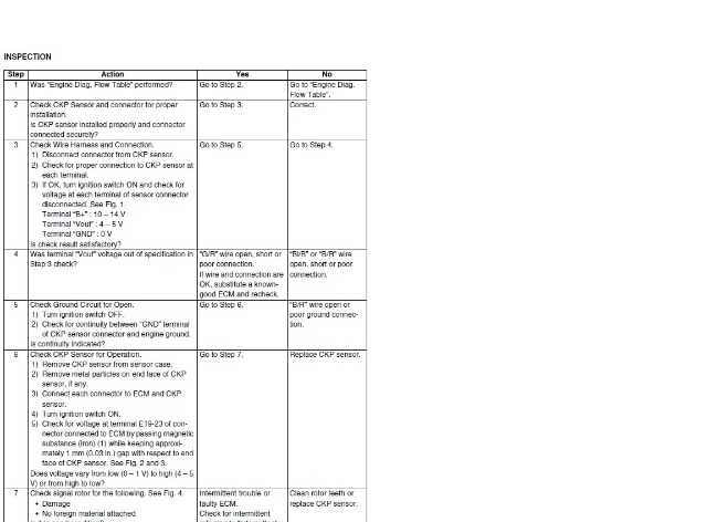

This fault code means NO CKP sensor signal for 2 seconds at engine cranking. So it is only checked on initial cranking which explains why it can be cleared until the next start.
Causes are listed as:
CKP sensor circuit open or short.
Signal teeth damaged.
CKP sensor malfunction, foreign material being attached or improper installation.
ECM malfunction.
ECM malfunction.
