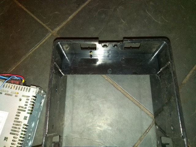

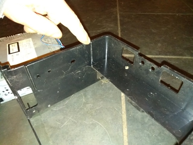

Replied by jackonlyjack on topic 2 x Single DIN - does it fit
Has a straight fit NO
Where. my finger is pointing the rib will need removing to allow it to slide all the way in and it's not quite single din size
But you can fit anything if you try hard enough
May require some cutting and removal of ash tray

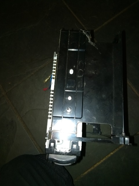

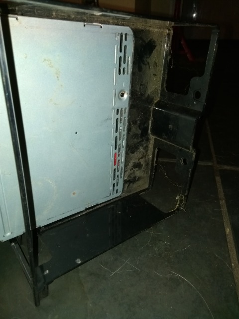

If you reduce the height of the plastic surround
it would be possible i'm sure
