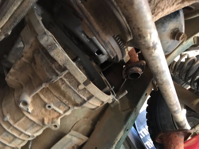

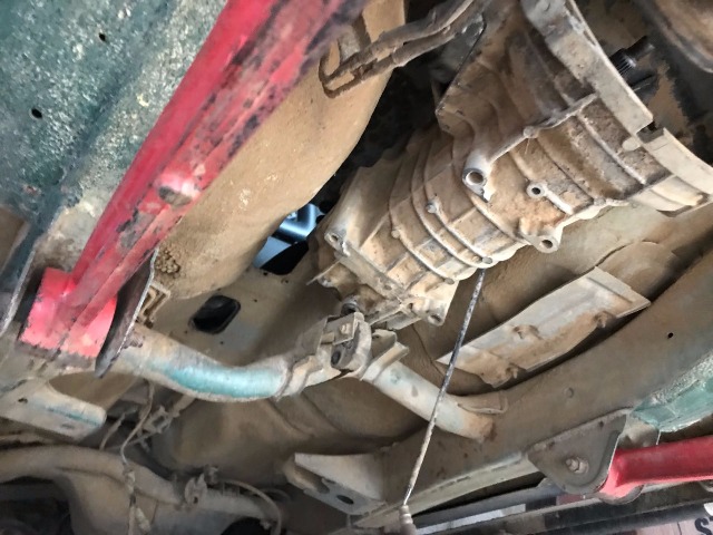

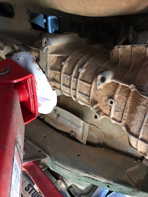

Well....progress. I've removed the gear selection mechanism from the back and she's free!
The following pictures may be very familiar to some of you....I can't get the sodding thing out.
I'm working under the car with it on wheel ramps so laying on my back it's quite hard to maneuver it, without worrying too much about it coming down on me! The next step I can think of is to tip the engine forward a bit with some straps just to get the little extra room needed.

Yes, I had to pull the engine forward using ratchet straps when I did it years ago
