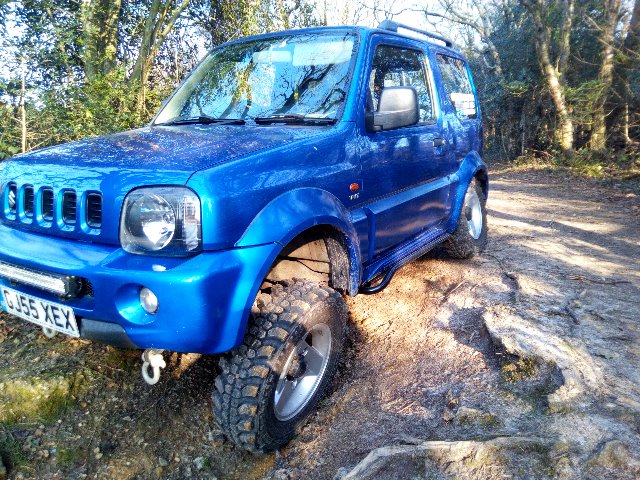

not an expert but I do have a 2" lift (spring) The standard brake hoses are fine if you are not removing the anti-roll bar.
The shock spacers will let the suspension droop a little farther before the shock tops out. I only have them on the rear as
when I fitted the springs the anti-roll bar was still on so limiting the front end travel. Its off know.
Last edit: 13 Aug 2017 09:20 by 1066Boy. Reason: Photo
