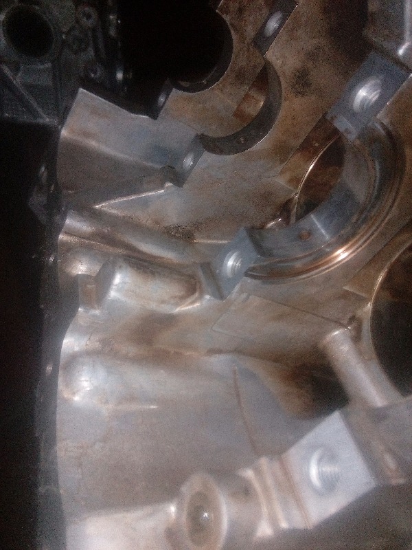

It was 12 point splines.got them off with a 10 kingtony hex socet.It just got better.my block is cracked
