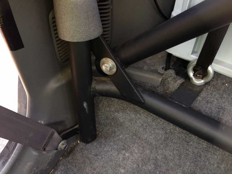

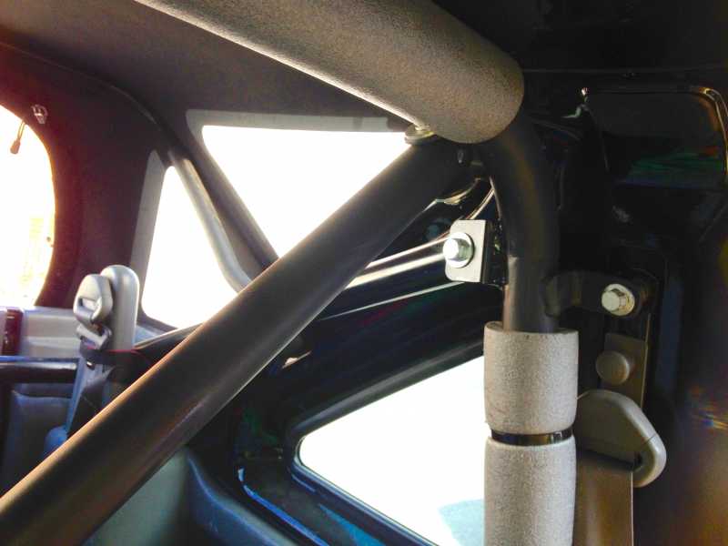

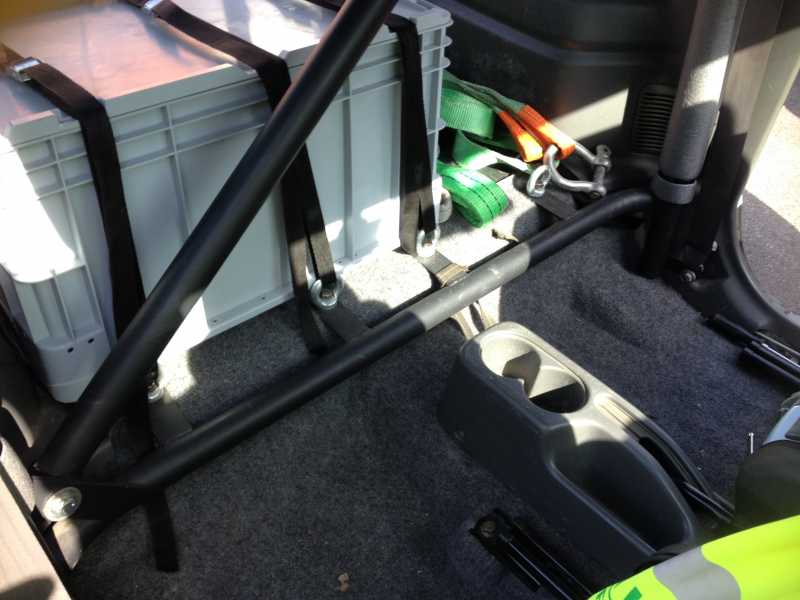

This is my internal rollcage.
The middle-hoop is fixed at the upper and lower safetybelt fixings.
At he bottom of it i have a lateraltube that is welded to the hoop and fixed at the four fixings off the backseats.
Hope this can give you a idea.

viciouspenguin wrote: Nice!
Do you make it?
Maybe looking nice. But that cage is nowhere nearly as strong a a cage with a main hoop with proper diagonal tubing. When having a cage made make sure it's by someone that knows their stuff.
