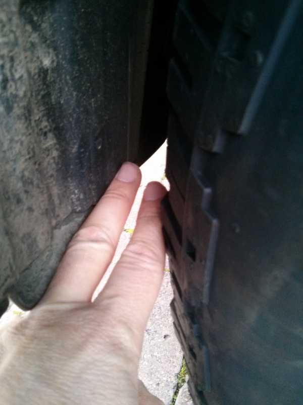

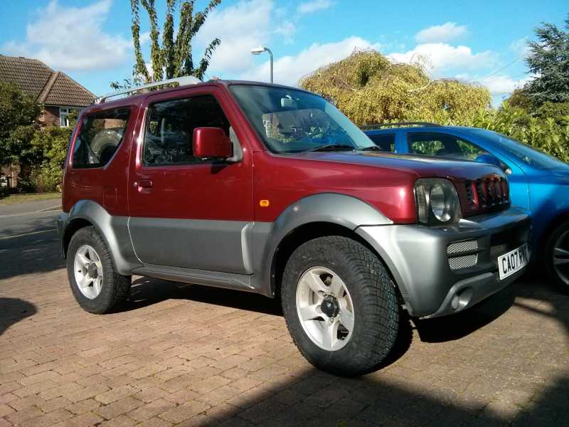

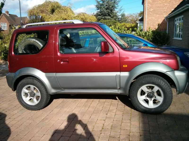

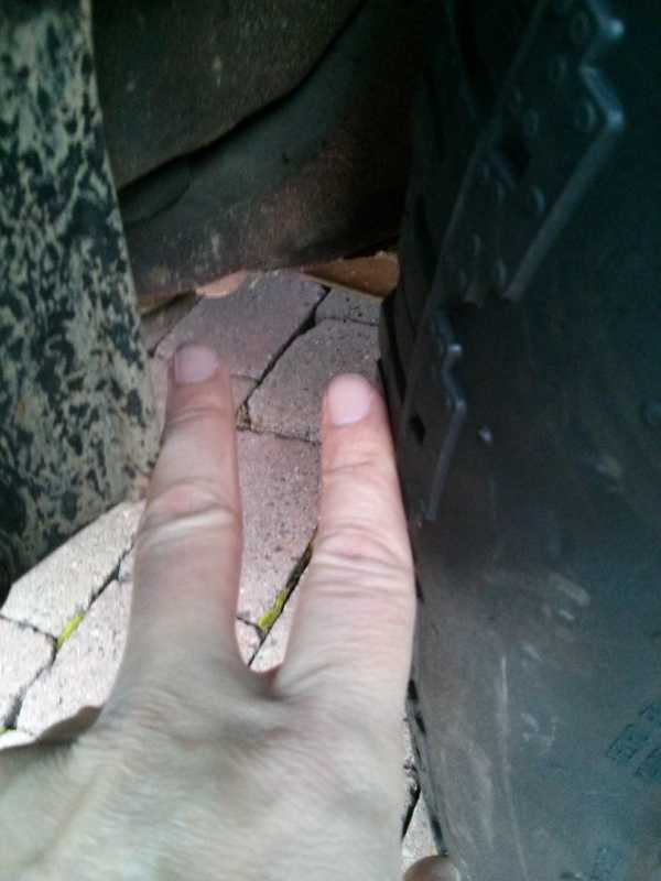

For comparison, I also had 205/75/15 Grabber ATs fitted yesterday. Standard suspension, 2007 bumpers, but still on standard non-offset alloys.
Before
After
Clearances on front wheel at full lock
Clearances on front wheel at one turn of lock
This is all on the (almost) flat obviously. That inboard bracket looks like a potential rubbing point as the axle moves - should be able to check full axle articulation in a couple of weeks when I next play off road.

Before
After

You should be ok unless you remove the arb.

They look good, I really don't think they will clear the upper arches at articulation tho, might be wrong.

The difference between 205/75 and 215/75 r15 is 14mm diameter, so 7mm radius. You've clearly shown there is much more space around the tyre than 7mm and I can tell you from experience there is enough clearance at the top of the arch, even with the ARB removed. Off-set wheels would cause an issue, but 215s on standard rims are fine!
