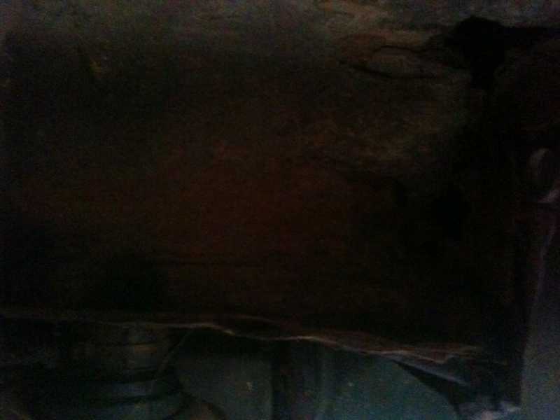

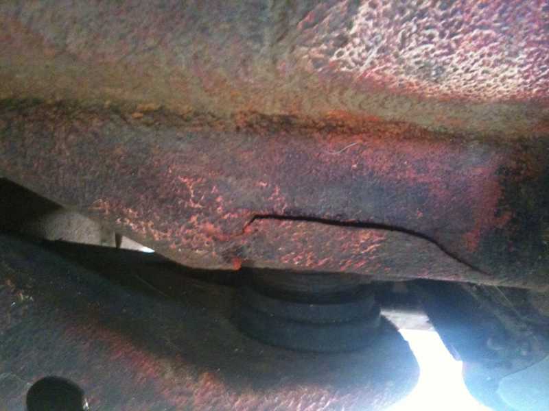

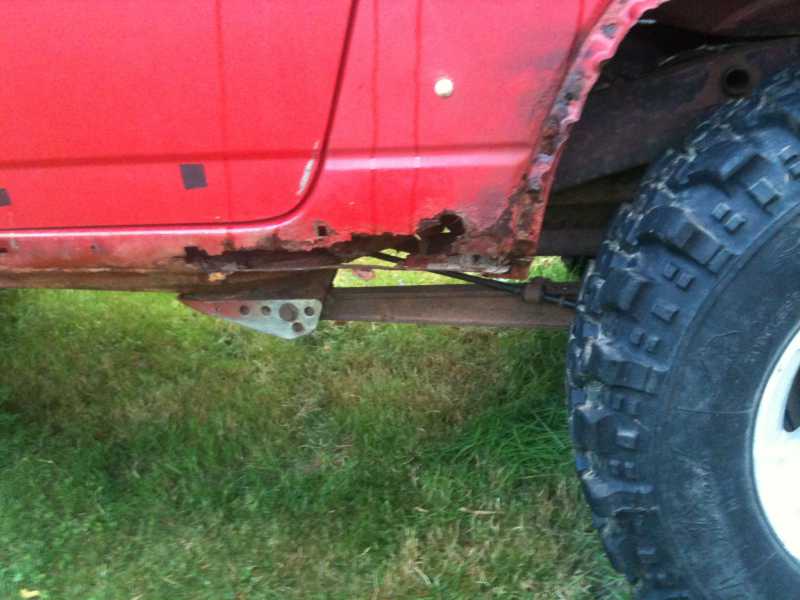

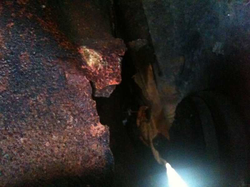

09 Sep 2015 08:23 #151579
by Back in Black
Replied by Back in Black on topic MOT Epic fail........
Thanks guys for the feedback - I've attached the mot for clarification - the exhaust is no worries, I have a cherry bomb on the back (which passed last year!?) so could get a back box for a retest, the coil spring is easily replaced, and I can take the tow bar off (this was on last year too).
Its the mounting issues that are the ball breakers!! If it is fixable, I'm presuming it is it a body off job for welder access?
Time to build a beach buggy perhaps?
- Posts: 9936
- Thank you received: 1985
09 Sep 2015 09:23 #151580
Replied by Lambert on topic MOT Epic fail........
Reading that and with you saying you can't weld I would seriously be looking for a new one because garage prices for all that will be more than it is worth. Alternatively if you have other transport I would think about taking it off the road for a few months and doing a welding course at the local night school and do it yourself but even so it will be a lot of work , especially without a workshop and ramp.
