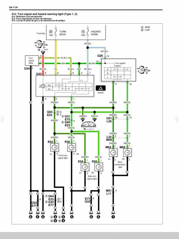

Hi guys,
So after getting my new carling hazard warning switch shipped from Australia, I'm a bit stumped as the switch has 4 pins on the back but the hazard switch in currently (stock) has 8...found the wiring diagram for the stock switch on Google but before I go ahead with trial and error and s hell of a lot of blown fuses, does anyone know how to wire this up?

- oxford_bloke
11 years 4 months ago #147820
by oxford_bloke
Replied by oxford_bloke on topic Carling switch for hazards
if it was me i would take a photo of it working correctly, so if it all goes pete tong then you can pit it back write. Then disconnect all the wires. Get a multimeter and work out which pin connects to which via a continuity test. flick the switch and do the same again so you can work out which wires "join" together. you can then re create this on your new switch, by doubling up wires if needs be

by facade
Replied by facade on topic Carling switch for hazards
I didn't know Carling made switches, I thought it was just lager.
What is wrong with the original one? (Never "fix" what ain't broke
A quick google shows that MudUK sell them, and there is a wiring diagram with the fitting instructions, but there are loads of wires, not 4. www.mudstuff.co.uk/carling-hazard-switch.html
The 4 wire switches are SPST with an illumination bulb, have you got the right one?

11 years 4 months ago #147833
by tommyguns
Replied by tommyguns on topic Carling switch for hazards
yeah thanks oxford bloke, have taken tons of pics and cut the wires 10mm from the switch so i can see which one goes to which in the terminal. will have a go with the multimeter and see how i get on!
