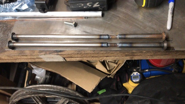

The bar from the Jimny seat that needs extended is hollow. I just cut it and used a tap to thread the inside of it out to M6 (possibly M8? i cant remember). I then used a bit of threaded rod and a couple of nuts to secure it. This was handy as it allowed a bit of adjustment to get the length just right and the securing nuts make it stay together properly too

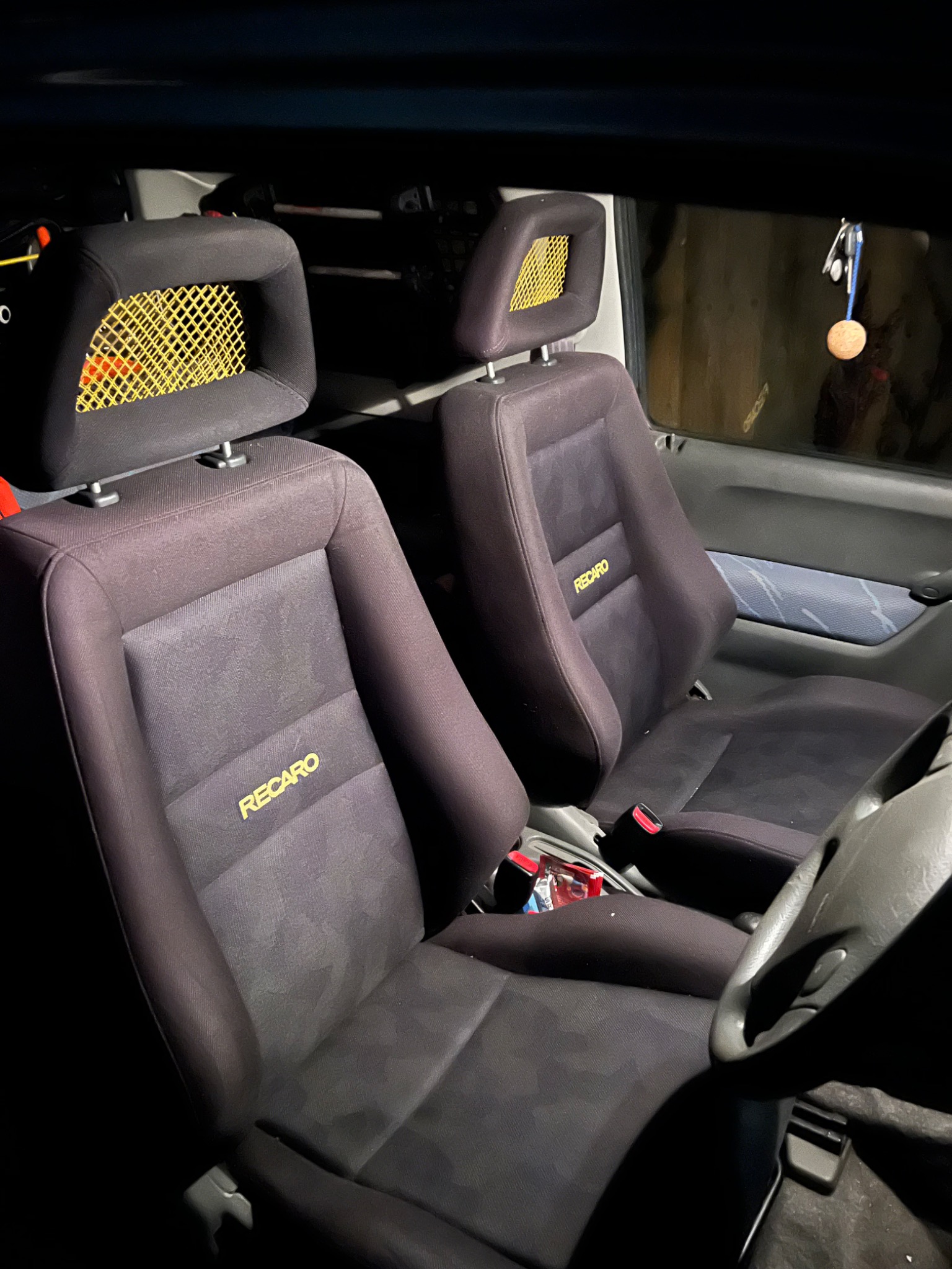

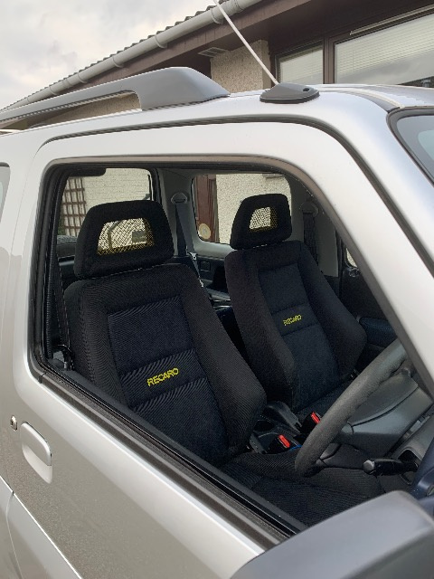

Well today was the day i joined the Recaro club. After a 8hr round trip from the east of england to the welsh boarder i couldn't wait any longer to get these fitted.
This was a good chance to practice my welding skills with the welder Mrs Hart said i didnt need as never used……. 🤔
anyway the end result!
time for pizza and a film!
Thanks for the detailed write up.
